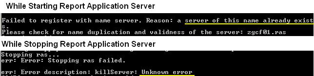

Hi Experts,
I am also facing the same problem but the error code which I got is %12 (i.e, “zgcf01.ras - Report Application Server: Failed to start/stop service on remote machine: Error: Failed to run rexec. Error number: %12.”) with BOXI R2 SP3 installed on Solaris server.
I tried stopping and starting the RAS through telnet console, however that also fails. :hb:
Please have a look at the screeshot attached for the exact error which I got in telnet console, while starting and stopping RAS.
Please help me :cry:
Sundar
