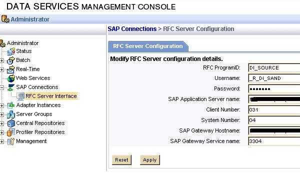

We have updated from 12.2.2.1 to 12.2.2.3 to fix this issue, but the issue remains - Jobs still queue rather than run in parallel. Does additional configuration need to happen to force multithreading?
The update was performed by uninstalling 12.2.2.1 but leaving the directory structure and config files in place, then running a full install.
Tom
TomA2011 :australia: (BOB member since 2011-02-07)
In the management console go the to RFC Server config. There you have a setting regarding the number of threads supported. I hope it is that.
That option doesn’t seem to be available (see attached screenshot).
Tom
