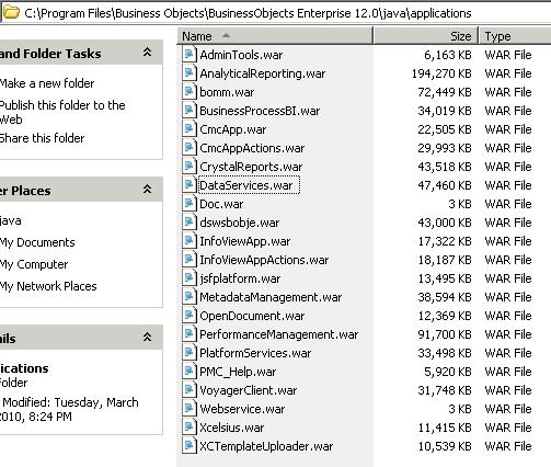

check if you have these war files installed ? do a search for DataServices.war in BusinessObjects folder
if you don’t want to use wdeploy script to deploy the war files, you can use tomcat manager to do that, it will not mess up your exisiting installation, you can check tomcat documentation for doing that
PFA
This is the final solution.
I have also seen the SAP Note 1347589 - Web Application manual deployment procedure . But didn’t get relevant to my case.
