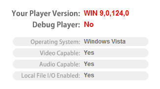

if you go to this page,
http://kb.adobe.com/selfservice/viewContent.do?externalId=tn_15507
does it show that you have flash installed?
How do you know that it’s flash missing? Do you have Excel installed on this machine?

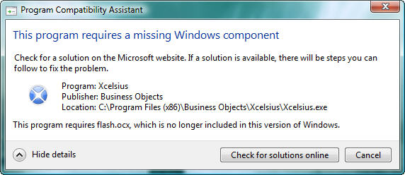

Sorry, here are some screenshots to demo the problem.
1.jpg shows what happens when I first open Xcelsius 2008 SP1.
2.jpg shows the next screen - if I get help from Microsoft, they just tell me to reinstall Flash, which didn’t work.
3.jpg shows the results from the website you pointed me to, which tells me that the latest version of Flash is installed.

Hi everyone,
Just to add that I successfully resolved this issue. I removed all instances of Adobe Flash, then removed Xcelsius 2008 SP1.
I then rebooted, and reinstalled Xcelsius 2008 SP1. This installs a version of Adobe Flash with it.
Xcelsius 2008 then successfully started.
