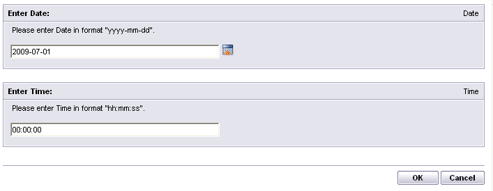

Here’s what my parameter screen would look like :
Can you show us yours?
zorgov (BOB member since 2008-12-16)
