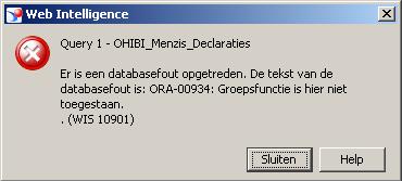

If you use the wm_concat in an object definiton the sql is e.g.
The original SQl that is created by Business Objects is :
select sum(measure1), dim1, dim2, wm_concat(dim3)
from table x
group by dim1, dim2, wm_concat(dim3)
if you run this in the query panel you 'll get an error> See attachment
If you alter the SQL and remove the wm_concat object from the group by it works!
Then it would be this:
from table x
group by dim1, dim2
I am using BO XI 3.1 SP1 with Oracle 11g R1
TurningPointHolland :netherlands: (BOB member since 2006-09-06)
And that indeed is the correct behevaior :slight_smile:
I don’t know dutch but that error would translate to “group function is not allowed here” (At least on English DB Versions 8) ) and the reason is because you are using WM_CONCAT() in the group by clause. WM_CONCAT(), just like SUM(), MAX() or MIN() is considered like an Aggregate/Analytic function which cannot be used in Group By Clause (but can be used in Having clause). Try replacing WM_CONCAT() by SUM() and you should end up on the same error.
