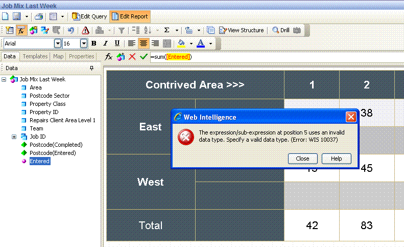

I’m having a really odd problem. (Webi XI R2). I have a data provider returning [Job ID]'s entered on our system in a week. I create a measure called [Entered] in my report which is just =Count([Entered].[Job ID]). That measure is of type ‘number’. This is one of two queries/data providers in my report hence the [Entered].[Job ID] bit - I have another query called Completed that contains Job IDs that were completed.
I’ve created a simple crosstab report with East/West area names in the vertical data bit (on the left) and sub area numbers in the horizontal bit on top and dropped in [Entered] as the value.
This is the confusing bit. I right click [Entered] value and insert a sum row and column (all this as per my attachment). Now, the formula for that sum of [Entered] is obviously just =sum([Entered])…
Now, I want to insert a formula in a second row (currently blank in attachment) which I want to get me the % each figure is of the total in the week.
Easy??? Is it rubbish! I can’t get webi to treat [Entered] as a number measure. I originally tried to start writing my formula by writing =[Entered]/sum([Entered]) in ([Area]) in my blank row but that came up with the WIS 10037 error… So I tried doing simpler things and can’t even enter =sum([Entered]) in the cell without getting the same error which is a bit bonkers because that’s obviously the formula in the bottom footer row of the table = :reallymad: / :hb: !

Just one last quick thing - I’ve also tried wrapping the formula in the Entered measure in tonumber() to double force it to be recognised as a number, but also to no avail…

This is not really making sense. It should work. I assume the cells on the left are merged cells? What is in the Contrived Area >>>" cell?. Maybe it doesn’t like that you named a variable the same name as a query?
Bobber :us: (BOB member since 2009-08-28)
Your are spot on - it doesn’t make sense.
The Contrived Area>>> is just text entered into a cell. The cells with East and West in them are merged.
I did manage to get this to work yesterday but only by creating a new variable called [Entered Percentage in Team] which gave me
=Count([Entered].[Job ID])/Sum(Count([Entered].[Job ID])) In ([Team])
That works, however what I was originally trying to do should have worked. I wonder if you’re right about naming a variable the same name as a data provider? How can that be an issue when a report level variable quite clearly should be at a different hierachical level in the document that the data provider… VB doesn’t have this kind of issue!
Very strange!
PS - I changed what I wanted out of the report and switched to wanting percentage in Team, not Area; I got the same original WIS error either way.
SteveD :uk: (BOB member since 2009-11-02)

I had similar issue with wis 10037. I could not get multiplication or division to work.
My issue was that both query and measure were named Transactions. After changing the measure name to Transaction1 everything worked. Lesson learned: Queries are objects as well and can be manipulated or referenced in formulas
Ilkka
Vaahto (BOB member since 2013-12-16)
I have found that if an object within a query has the same name as the query itself. The object in Webi is defined as:-
ClassName.ObjectName
e.g If you have a query called Weighting and an object called Weighting that is contained within the Weighting Measures class it will appear as:-
Weighting Measures.Weighting
Qualifying as above when using in formula seems to make the calculations work.
