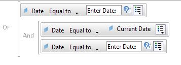

This is how I accomplish this via the Report:
(The prompts are optional).
If you leave the optional prompt blank it will return the current date, or if you select a date via the prompt it will return the selected date. Schedule the report with the optional prompt left blank which will return current data, then when a user refreshes the report they can choose a date to run if so required.

Helllo,
Here, do I need to choose/check box OPTIONAL PROMPTS option for DATE objects? If yes, do i need to check for all DATE objects including LINE1 and LINE 3??
Please elaborate.
chaithu1983 (BOB member since 2009-05-19)
Yes.
