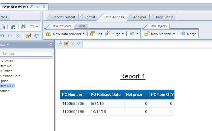

Hi, I’m facing the same issue where Webi results do not match the BEx query results. The Webi report is built off the same BEx query.

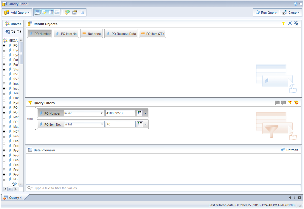

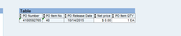

The result in BEx is only showing one “PO Release Date” for this PO Number and PO Item No. In Webi there are two PO Release Dates for this same PO Number/PO Item No. The correct PO Release Date is 10/14/15 according to ERP system. However, the 09/24/15 was the old value. I am on BO4 SP9.1 [/img][/url]

Right click, format table.
Uncheck:
Show rows for which all measure values = 0
Show rows for which the sum of measure values = 0
I’ve unchecked the boxes however, the row with the 09/24 Release Date still appears.
iam757 (BOB member since 2011-08-17)
That will be because you’ve got Net Price as a measure. It should be a Dimension. :slight_smile:
I removed Net Price from the query and kept the two boxes unchecked
(Show rows for which all measure values = 0 and Show rows for which the sum of measure values = 0). Now it is only showing one row with the 10/14 PO Release Date. Why should Net Price be a dimension if it’s a dollar value?
