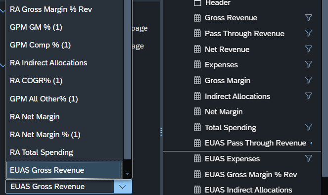

I have multiple blocks on my report. I’m trying to use Relative Position of the blocks to place them vertically to allow for more/less rows in the block.
For one block, I can position the top of the table on the Bottom side of any other block on the report.
For a different block, when I use the same type of reference, the full list of reference blocks are not available. Some other blocks are there but not all of them. Why wouldn’t all of the block be available for relative positioning?

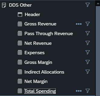

There are no sections in the report. Just many blocks. It’s very weird behavior. I moved “B” block to the same relative vertical position as the problem one (“A” block). I was then able to select any of the reference blocks for the A block and move it below where I was trying to put it originally.
I have 4 groups of the same 8 blocks - so 32 blocks total. It’s seemingly random as to which blocks I can reference for relative positions.
These blocks, I can only reference the blocks before/behind each of them.
But the very next one, I can reference any other block on the report whether it is in front/below it or behind/before it.
