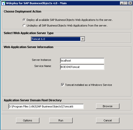

I’ll attach a screen-shot to show where I am currently at within this process.

How do I complete the Web Deploy process. Do I undeploy or redeploy? I am also unsure about the default service name and instance. Does that information get pulled for a file which was already configured?
arkiekeeper (BOB member since 2011-08-09)
Your Tomcat Service name and instance values seem to be correct. If you do not have your web apps deployed already, then yes go ahead and redeploy them.
In order to check whether your applications are deployed or not, click on your BILaunchPad or CMC links. If you can access them, then there is no need to redeploy anything.
Normally, all web applications get deployed when you install a Patch or FixPack.

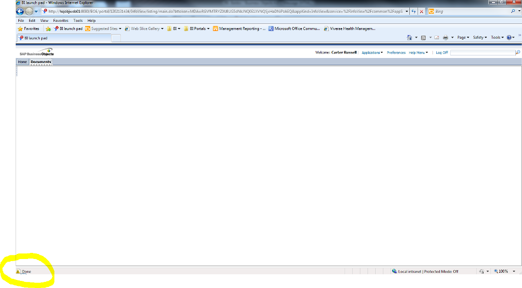

The web-app server seems to work, however, I can’t access the “Document” tab through BI LaunchPad and the overall performance seems much slower pre-upgrade (sp2.9). I will post a pic of the “Docment” tab error and the error code.
“Document” tab error:

Thanks for your help!

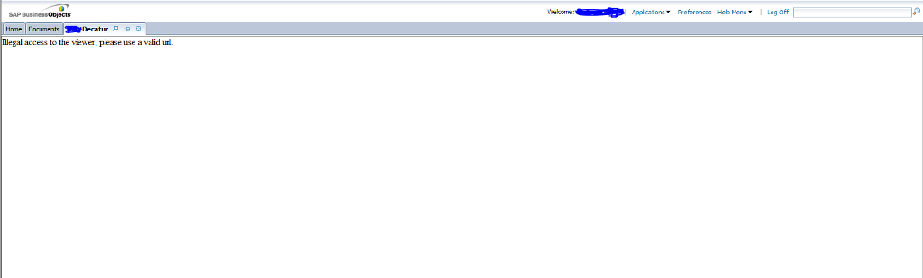

I can not access any links through CMC though I can see them.
When I try and access a pre-existing WEBI report through BI LaunchPad history I can the error below via screenshot. Should I redeploy? When I deployed, I did not run “as Administrator”.

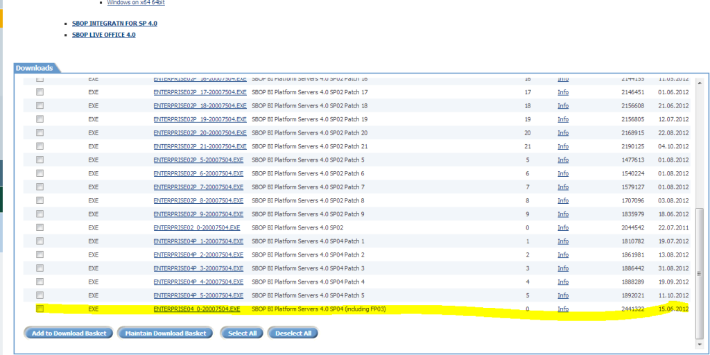

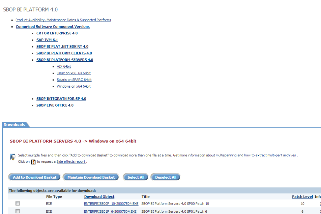

I installed ENTERPRISE04_0-20007504.EXE (which is underneath SBOP BI PLATFORM (ENTERPRISE) > SBOP BI PLATFORM 4.0 > SBOP BI PLATFORM SERVERS 4.0) the following on the three servers below:
web-app server
clustered node 1
clustered node 2
file name is ENTERPRISE04_0-20007504.EXE
Was I supposed to install the client version on the web-app? I attached some screenshots to where I downloaded the files.
Thanks!
