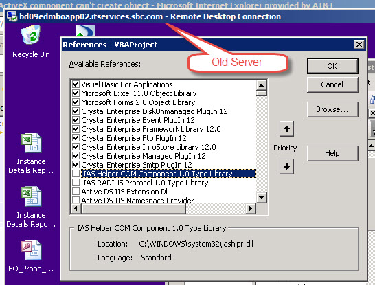

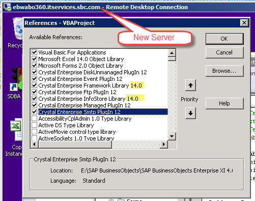

On the attached pics, you can see that on the new server, (2) libraries are “14.0” vs. “12”…Framework Library and InfoStore Library. I also tried copying the “12” versions from my older server onto a separate directory on the new server, then remapping those two VBA references to them, but even when all my VBA references are to 12.0 the same issue happens.
