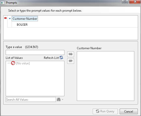

And here is what comes up in the prompt…
Note the BOUSER under Customer Number which causes LOV Refresh to come up blank.

I just created a test object, although with a simpler SQL, and it behaved as expected.
This thread is about a similar problem. The recommended solution is to not use modified SQL; I did not have the problem even though I used modified SQL, but it might be worth a try for you.

Thanks for taking the time to assist. We are on an old XI R2 version and this does appear to be an intermittent bug. It worked before but no longer.
tmcd :us: (BOB member since 2005-10-02)
Oh, XIr2. This post mentions a similar problem in XIr2 that was identified as a bug.
