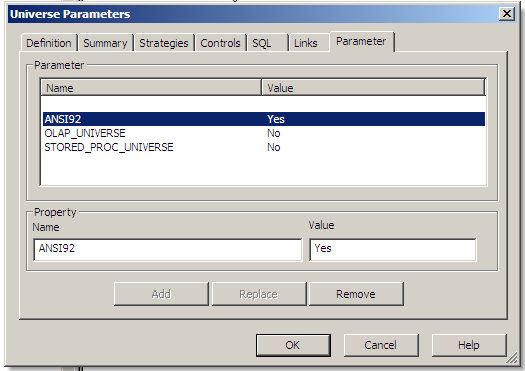

Have you set the ANSI 92 option to Yes in the universe parameters?
Mark,
Thanks for the reply.
Yes I have created a new universe and set ANSI92 parameter to yes. As far as I can see from the documentation this only affects the use of ANSI JOIN syntaxes and not identifier quoting characters.
Cheers,
Adam.
