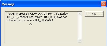

We are trying to upload the genereted abap programs directly into SAP R/3 application server using the feature of the R/3 data flows.
we are experiencing an error stating error GUI_UPLOAD.
note: We have the Z_AW_UPLOAD function module on the R/3 application server.
Anyone ever experienced the same issue?

The upload is done by the Designer client, you should check the dev_rfc.trc there.
Who is trying to start SAPGUI on a Unix box!?! Anyway, it was on 12th Jan, maybe somebody tried using direct_download as data transport function at that time…
We could not see any dev_rfc.trc file on the local machine but could find one on Job Server machine’s \bin folder.
We have even checked whether it has any entry for our upload activity, but there is none in the file.
Whenever we do the upload, it is popping the SAP Logon Screen and giving the error in the designer. Dont know whats happening.
Note: I see a pre-requisite to have SAP Logon installed on the machine where we are trying to upload generated programs task.

It might not be a feasible solution, but I figured out a way. Just change the Datastore setting to execute preloaded and try to upload the abaps.
Then check that on SAP Application Server, you will find them.
Let us know if you need anything else.

Yes, it works !
Thanks, Utopian.Santosh ! :smiley:
