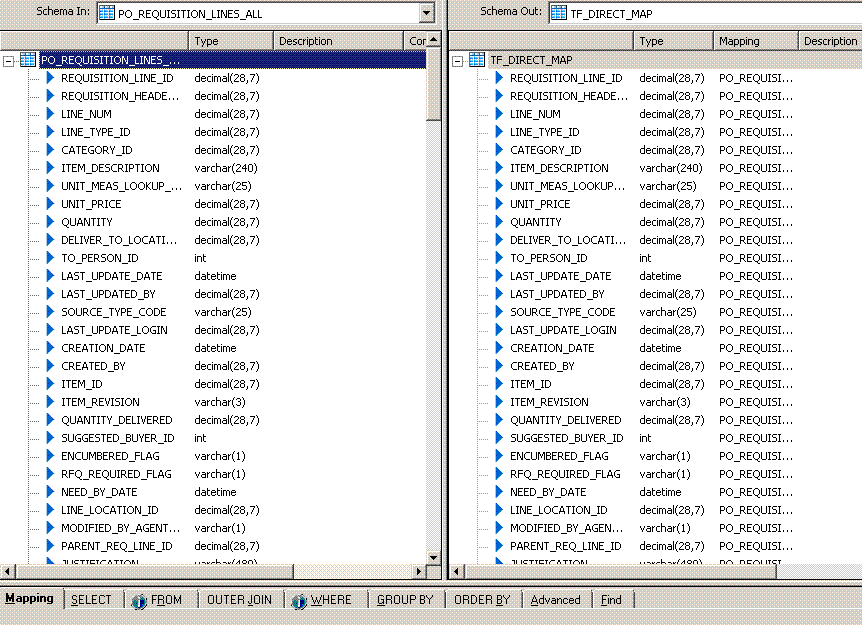

Please find the Screen shot of the dataflow
SK.Nid (BOB member since 2011-09-24)

Since no error specific to SQL Server or Oracle are in your log then I suspect the error is within DS. Check over all your code to make sure columns are mapped correctly. If you have DOP > 1 or Number of Loaders > 1 then set them back to 1 and try again.
eganjp
(BOB member since 2007-09-12)
