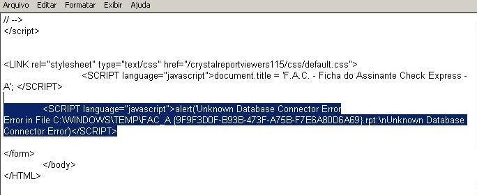

I’ve this message in my html and i can’t fix it !!
“Unknown Database Connector Error Error in File c:\windows\temp\fac_a{9f9f3d0f-b93b-473f-a75b-f7e6a80d6a69}.rpt:\n Unknow DataBase Connector Error”
I’m using ASP.NET 1.1, somebody know what is it?
Tks!!
