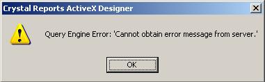

Also send me the screenshot of the error message
vadivelmothi (BOB member since 2008-11-03)
I have also posted this on oracle forum, and came to know that this is a known issue and there is some problem with oracle 10g.
It is only fixed in the later version…

I have downloaded the Datadirect driver and installed it on my local machine.
I was successfull in creating reports and overcome my issues regarding connectivity.
However when tried to deploy the report on the crystal report server,
I got an error
“failed to open connection Database Vendor Code: 12154”
