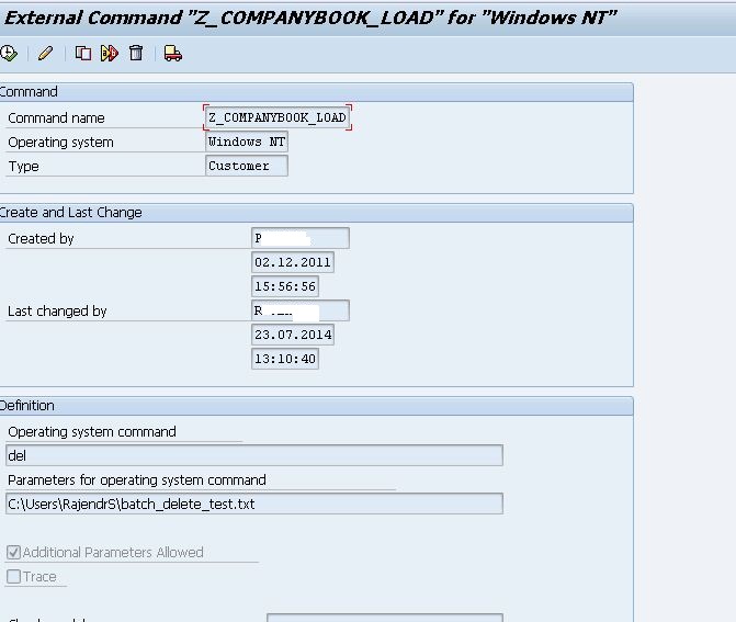

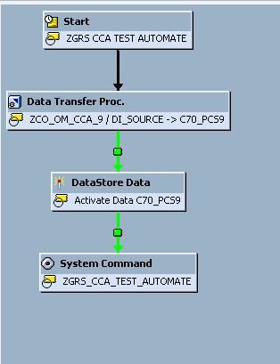

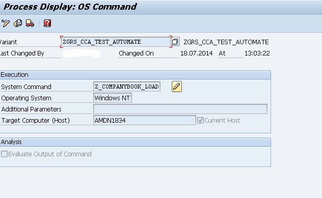

We’ve designed a process chain with OS command(.bat file exported from DS added here) to trigger the DS Job. However this process chain runs successfuly but failed to trigger the DS job. We doubt that the DS path maintained in the .bat file is not recognized by BW OS command. :hb:
Is there any other alternate way to trigger the DS job via BW process chain (or) how can we fix this issue?
The job design is like this . Once the data is loaded into datasource , in the process chain the OS command is added and this will trigger the BODS job (.bat). The BODS job will extract data from data source and push into BW open hub .
