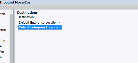

We recently built a box for BI4.2 SP5 , after I migrating all the content to the new box from OLD BO3.1 I cannot see scheduling options.
I enabled destinations in CMC and I am assuming that this is not rights issue since logging in as admin also I cannot see any other destinations.
The drop down just flickers and does not show any other destinations other than default destination.

Thank you for the tip unfortunately Chrome also same behavior attached a picture that shows apart from default nothing else is available as option even for Administrator
I am assuming IE11 is supported is that correct ?
even for admin is there any setting I need to change after migration to work? :hb:

Update:
The rights were not specified in the general section. Modified them to set to granted explicitly issue resolved.
