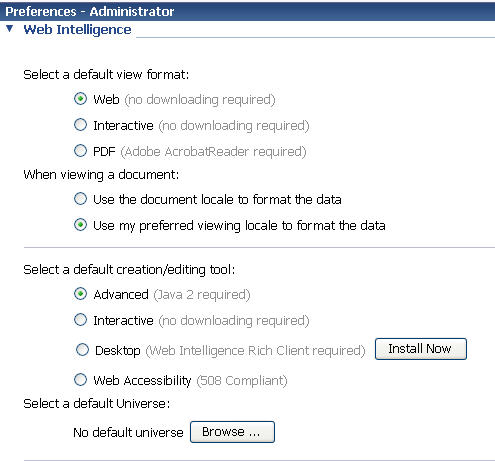

Hi Mak 1,
Thanks again for your reply. Please check the attached screen shot of my preferences for the Webi. I have not changed any thing here and was facing that problem.
GNK_BO (BOB member since 2007-07-17)
