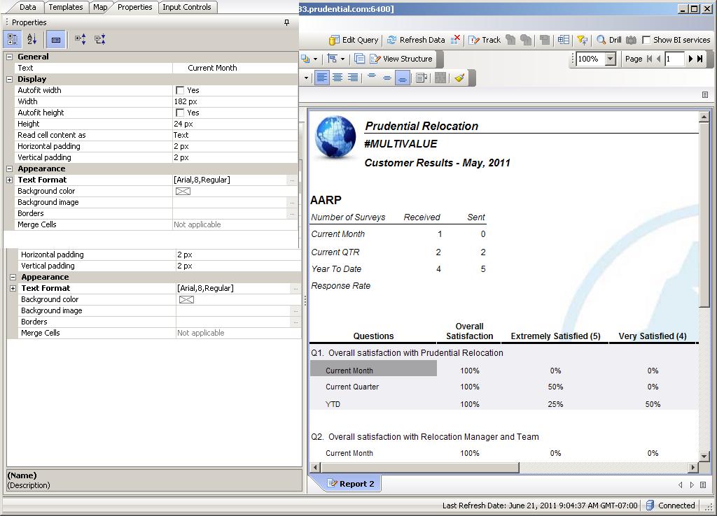

Maybe this is the issue - I’m using Rich Client. We’ve gotten in the bad habit of using the term Deski and Rich Client as the same thing - not sure if that’s accurate.
When I do as you suggest, after I click on Cell, I don’t get a “shading” tab. The Properties tab is opened and my only option to affect the cell color is the Background Color option. It defualts with RGB codes for white and I have removed them.
The box indicating the background color then shows and X through it impling there is no color. (See attachment)
SAP claims this is a defect and cannot be accomplished. If you know a way around the problem, that’s great!

The instructions were for Deski, I’m not aware of a workround for Rich Client

There’s a blog post here which suggests you can accomplish this by altering the defaultconfig.xml file:
http://michaelwelter.wordpress.com/2011/05/17/changing-default-formatting-in-web-intelligence/
[i]The thing I want to point out here is the BACKGROUND setting. You see, in Web Intelligence, you cannot set the cells in a table to be transparent. That’s always bugged me. However, you can set the background to be transparent by default by changing the BACKGROUND line to the following:
<BACKGROUND R=”" G=”" B=”"/>
If you do this, you probably want to do the same for the next section, alternate body cells in a table (Alternate Row Shading), so the entire body of the table is transparent. After making this change, your table body will be transparent by default, but you can add color, to the background if you choose.[/i]
Read the whole blog post for how to apply to Rich Client.
