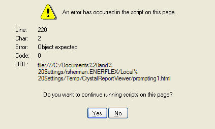

unfortunately when I run the report with active x viewer I am receiving Active X scripting errors. i have included a snapshot of one of the errors.
The only reason I can think of is because there are bound parameters for Oracle and possibly the active x controls don’t recognize them, only a guess.
If anyone knows how I can eleviate my original problem using the dhtml viewer or how i can fix the active x scriting errors that would be great.
