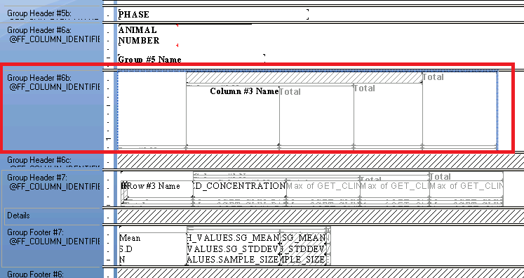

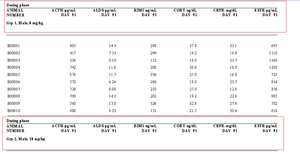

I have a new requirement where i need to show more than one group in a page and when both groups have same headers i should suppress the group header. if they are different i need to show them. Both the group header and details are a CrossTab reports.
Is there any kind of formula i should use or any section/group/header settings change? :?

 I tried the formula you mentioned. It is not working. I have only one field in crosstab group header. I want Group Header crosstab to be suppressed if they are repeating in the same Page. If they are different it should display.
I am attaching the screenshot of design and report.
Please Help…
