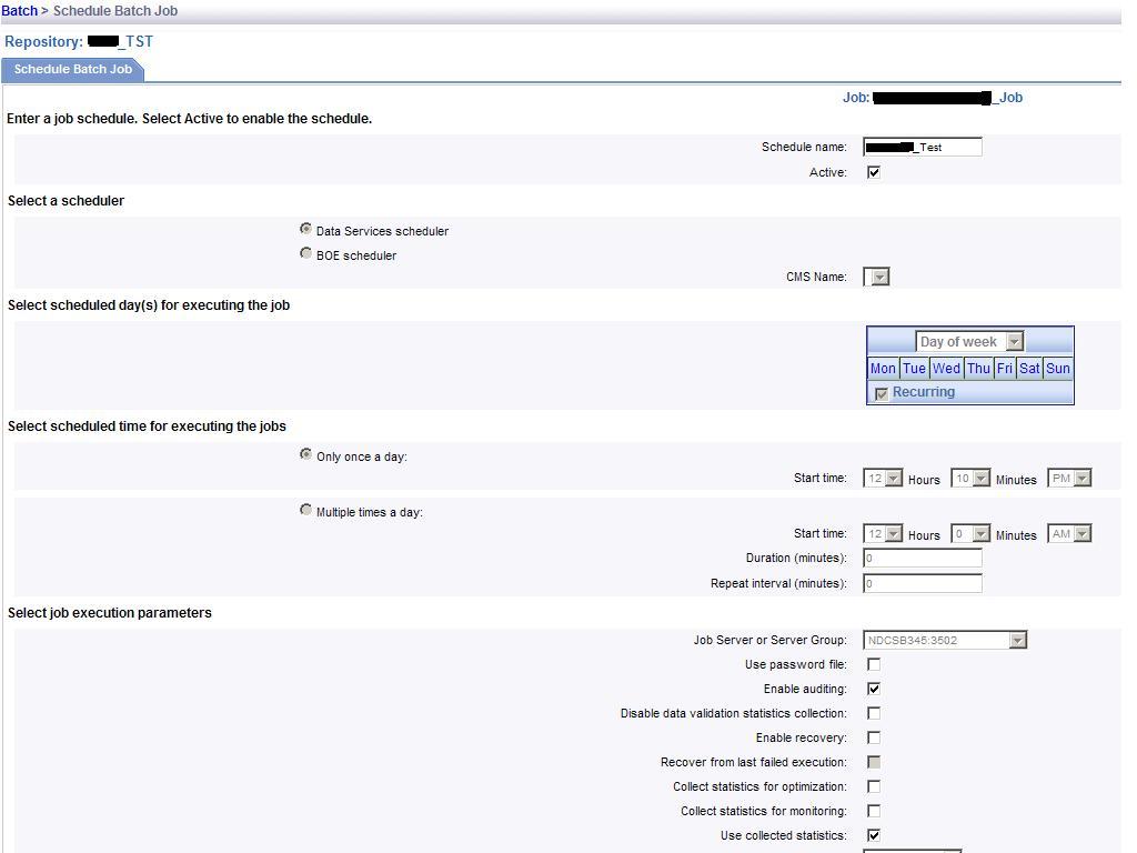

Hi Ganesh,
I know this is bit strange but I am not sure why this is still causing an issue.
I have attached the screenshots for DEV and TST. UAT is same as this with different time.
We export repo/job from DEV to TST and TST to UAT. Do you think this is causing running all the three scheduled jobs from UAT only?

Hey looked into your Screenshots!!!
Even me puzzled!!!
