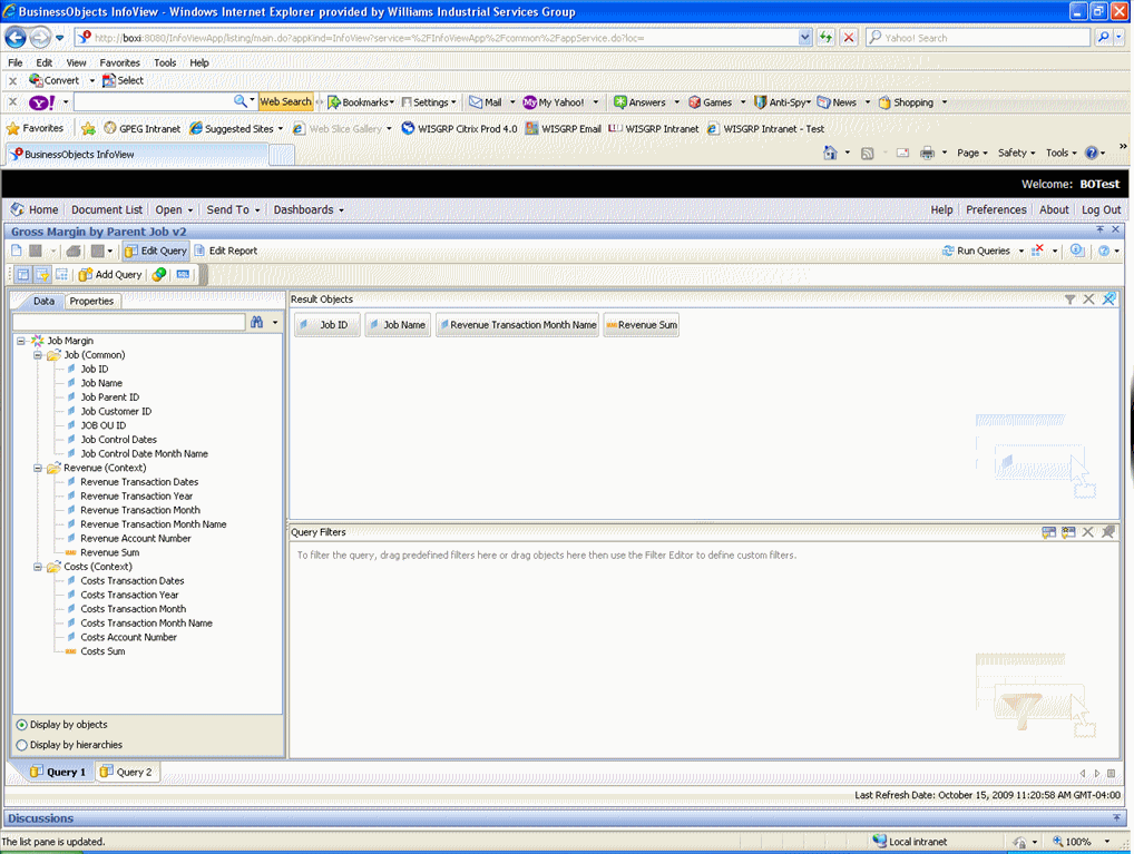

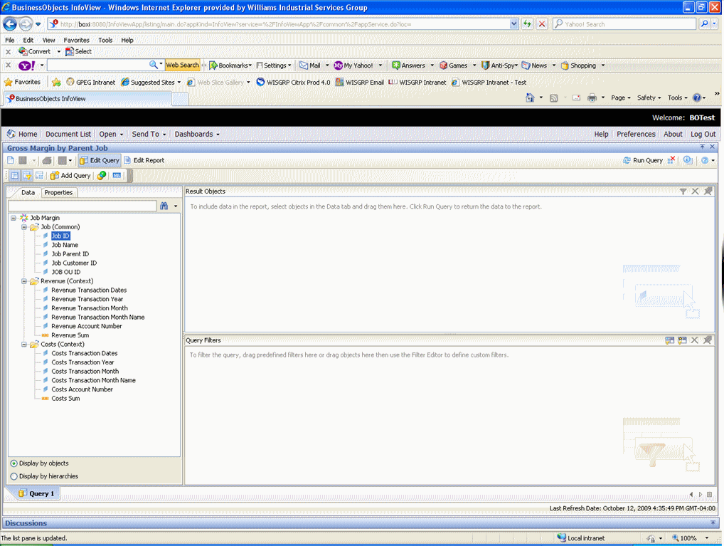

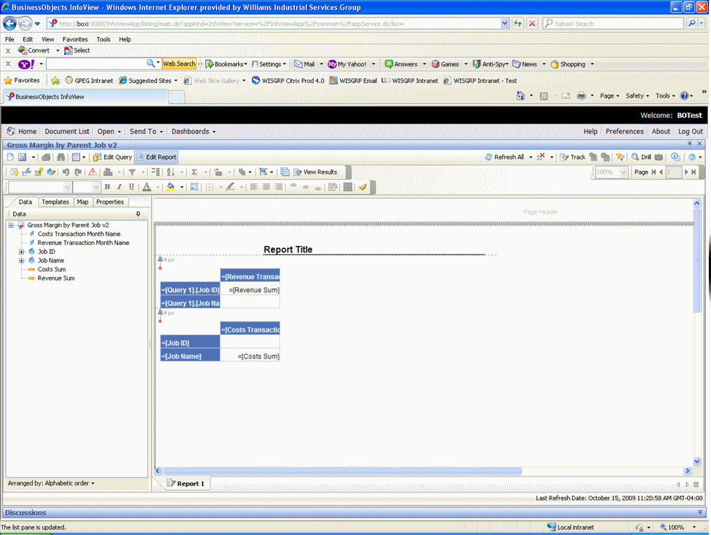

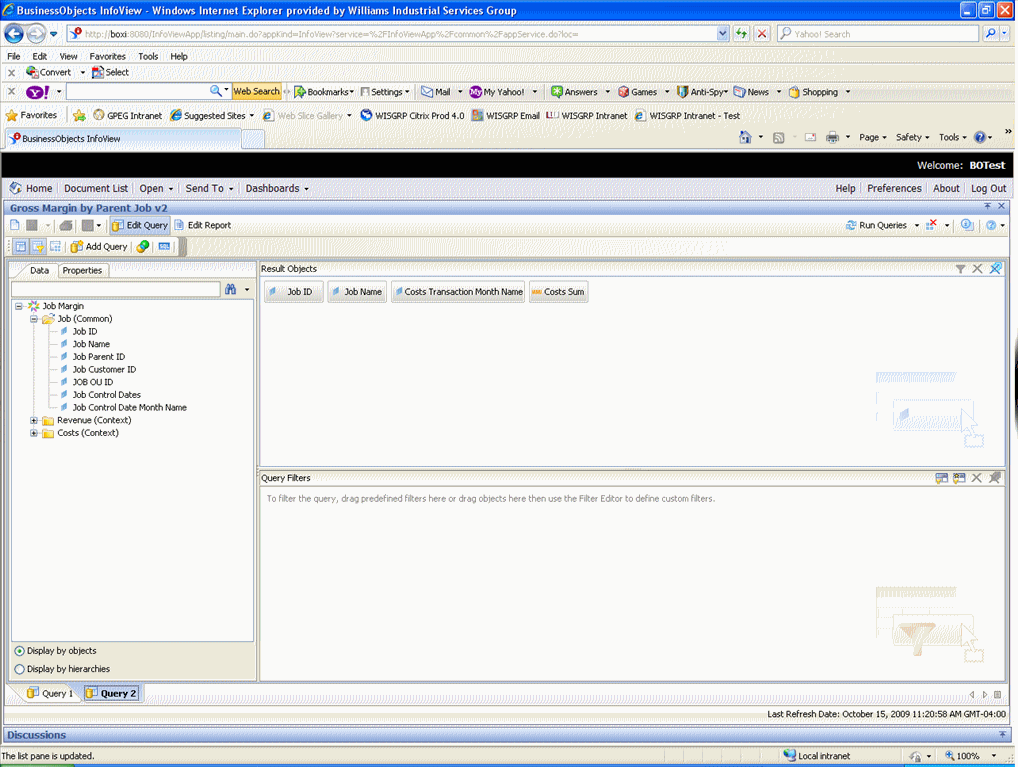

Still having trouble. I have attached three screen shots of my report queries and the report. Can’t figure out how to combine the two different sum measures when each one is coming from a different fact table. :hb:
rhodesdw (BOB member since 2009-06-26)
You need to merge your month fields.
There is a button that will allow you to merge dimensions on the tool bar.

That works. Thanks a bunch.

In addition you will have noticed two of your dimensions merged themselves.
This is because the object names are the same, so BO knows to merge them.
