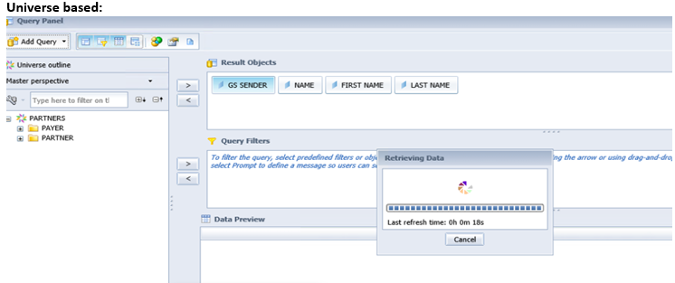

attaching the screenhots.

Query running in non bo tool takes like 2 to 3 secs , same query taking like 12min+ to run in BO.

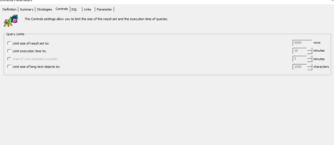

Nothing is checked in the Summary Tab of the Universe

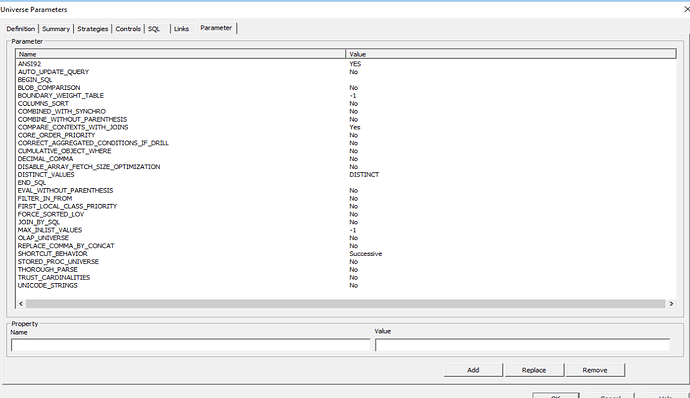

These are the parameters, do you think anything needs to be changed ?
And these are the same settings in our PROD server as well

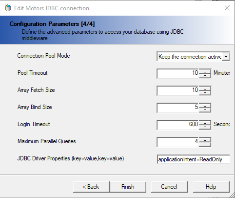

That’s the universe parameters. Fetch size is in the connection parameters. Increasing this can speed up your query but will transfer some load to your database so should be tested as you go.
When you say Connection Parameters, where do I see them, I am using JDBC connection
On the second screen of your JDBC connection, you can adjust the Array Fetch Size.
ok thanks for the tip. I changed the fetch size to 30, the query time was reduced to 4mins , and then i did 60 and query time was reduced to 2 mins.
but the question is that we have 10 set in prod, and it runs like in 12 secs, same like its running at SQL developer and PowerBI in UAT. what could be the issue then
I remember a default Fetch Size of 1000 !
It is the number of rows returned with every DB-roundtrip.
