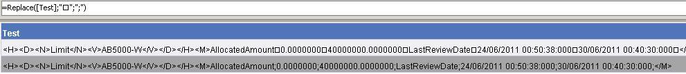

Hi…
Please try using following replace formula…
=Replace([Test];"cntrl char";";")
copy and paste the control character at string to replace position.
And the text you are trying to replace is Ctrl char ETX of Ascii 003.
Please find the image showing the result after applying above formula…
lnarayanan86 (BOB member since 2009-08-05)

i tried it before and I tried it again. no luck. Please see the attached screenshot.
Any other Ideas?

thanks everyone.
i tried Replace(Char(3);" ") and it works. thanks lnarayanan86
