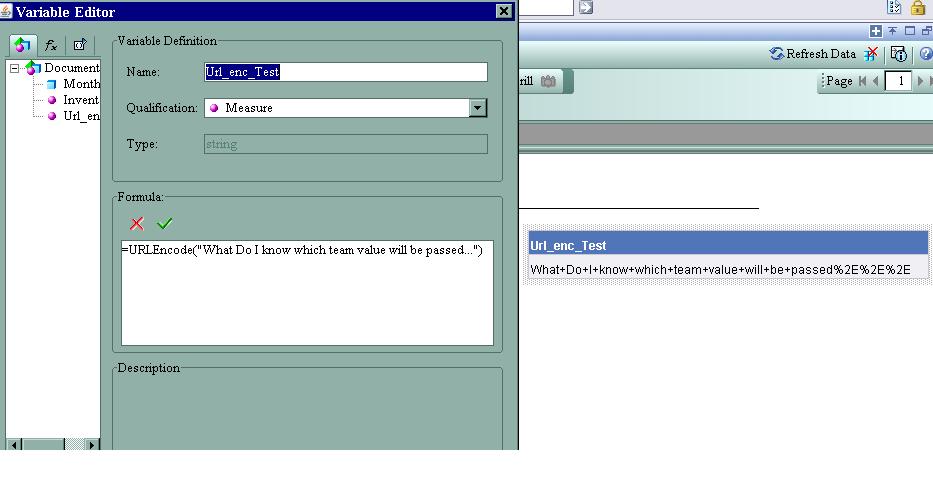

Andreas,
taking your example
, here is a screenshot of what UrlEncode will do with it (at least on my system – XI R2, SP4).
John
jsanzone :us: (BOB member since 2006-09-12)
