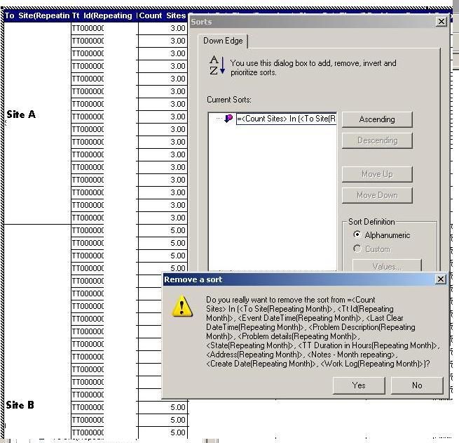

I have applied a break on “Site ID” and then added a sort.
What can be seen on the screenshot that i have provided is that after applying a break the context of the sort is overridden by the break.
Without the break the context of Count Site is “in Site_ID” (The site for some misterious reason doesn’t allow me to add more attachements so i can’t provide a screenshot of this) What am i doing wrong?

Hi Rafael,
Lets try one more thing.
  1. In the report, highlight site id
  2. Select Format/Breaks
  3. Select Break Footer
  4. In the report, select Count Sites and copy
  5. Paste Count Sites into the footer
  6. Format/Sorts, Select Add and choose the new count
  7. Remove the old count and apply
This should create the count in the context that you need. If this doesn’t work, I am kinda of out of ideas…
DC
MBTDC :us: (BOB member since 2007-12-28)
Hi MBTDC
Thank you very much.
Steps 4 & 5 made the difference
Again thank you for your help
