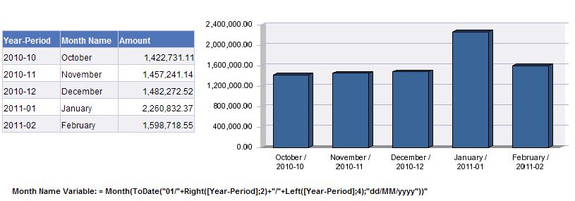

Confirmed - frustrating as the Alerters work perfectly well when testing using “Cell Contents”, just not with the Formula syntax?
For your requirement see the attached ; not perfect but hope it will suffice.

Hey, Thanks for getting back.
Yes, I guess this could be the closest solution… I too managed to get a similar look like the one below. Thanks again!
