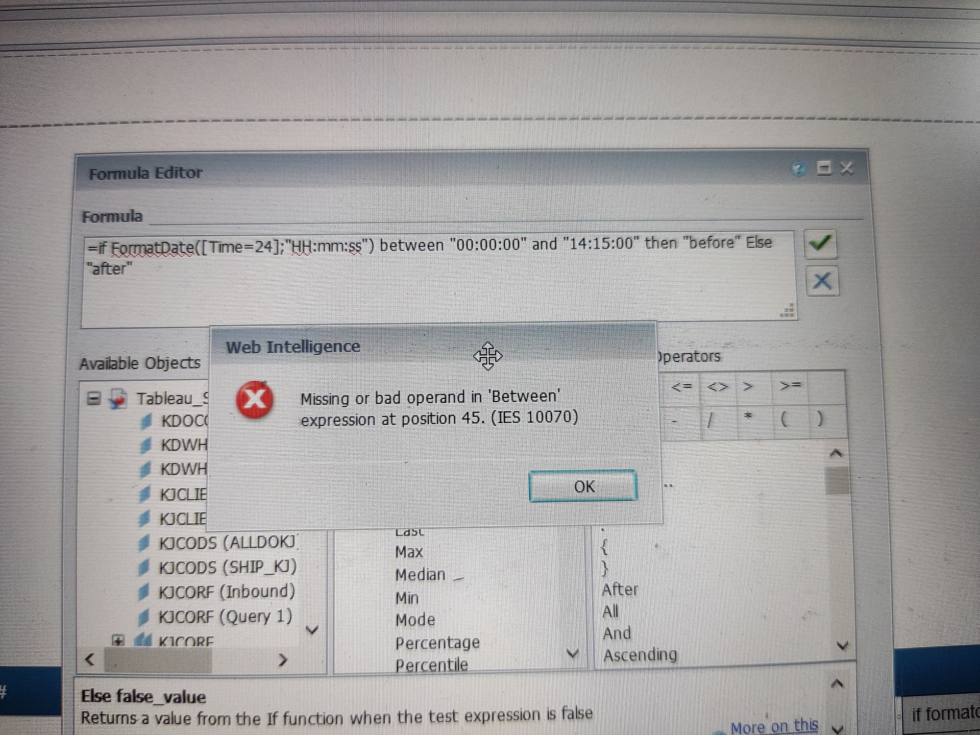

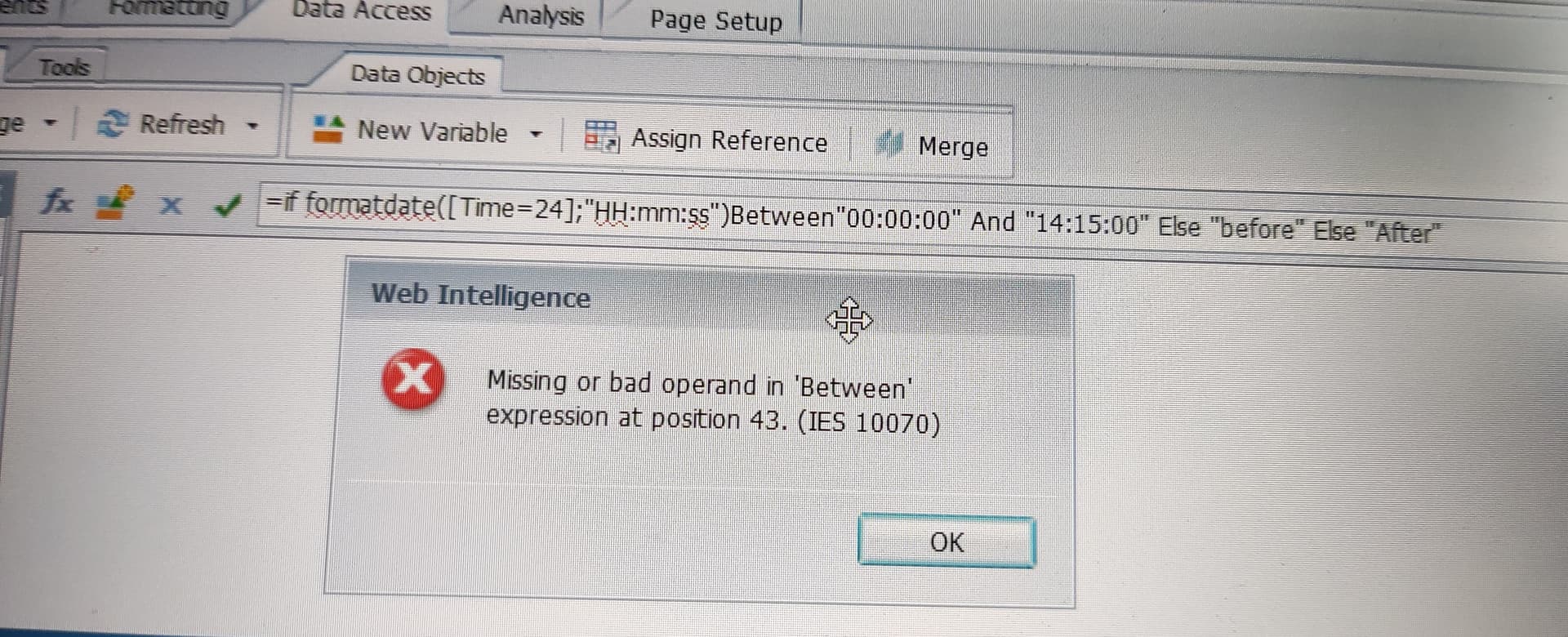

Hi dtolley,
I tried as per your guide. But stll getting error. Missing or bad operand in between expression at position 43 ( IES 10070).
Screen shot is attached
Pls guide.
BR
Sultan
The first “else” should be “then”
if formatdate( [Time=24] ; “HH:mm:ss” ) between “00:00:00” and “14:15:00” then “before” else “after”
Hi dtolley,
Still same error is coming.
Sorry, brain is on weekend mode. It’s between( "00:00:00 ; “14:15:00” )
