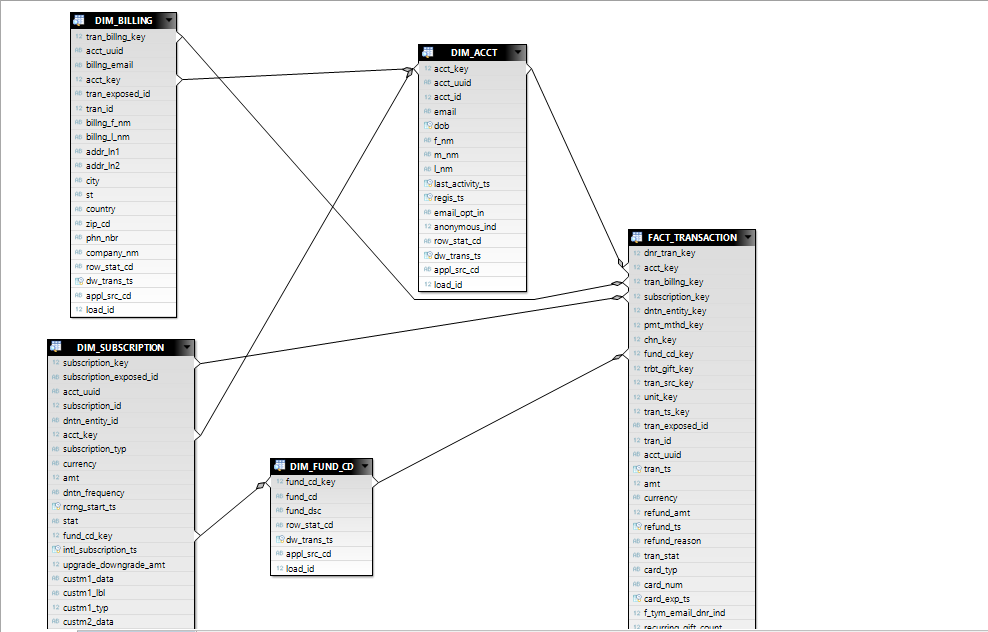

Hello Dave,
I have a scenario in which there are following 4 loops in total as shown in screenshot below.
  1. DIM_BILLING → DIM_ACCT → FACT_TRRANSACTION → DIM_BILLING
  2. DIM_SUBSCRIPTION → FACT_TRANSACTION → DIM_FUND_CD → DIM_SUBSCRIPTION
  3. DIM_SUBSCRIPTION → DIM_ACCT → FACT_TRANSACTION → DIM_SUBSCRIPTION
  4. DIM_SUBSCRIPTION → DIM_ACCT → FACT_TRANSACTION-> DIM_FUND_CD-> DIM_SUBSCRIPTION
I am thinking can I resolve the loops using shortcut joins in any case?
Please help me.
Thanks ,
Preeti
preeti_trp (BOB member since 2018-07-12)
These look like good candidates for shortcut joins:
fact_transaction - dim_subscription
fact_transaction - dim_billing
I assume dim_acct - dim_subscription would be a shortcut, but I can’t confirm without knowing more about the data.
Shortcut joins are not a loop resolution method. If your universe is not working before shortcuts, it won’t be working after either. :slight_smile: They’re only added as a performance measure.
If you haven’t read my blog post linked earlier, it might help. Good luck!
I would suggest that you need to resolve your loops with aliases or simply break some joins in this situation.
Why is DIM_BILLING joined to DIM_ACCT as well as FACT_TRANSACTION? What does that mean?
Why is DIM_SUBSCRIPTION joined to DIM_ACCT and to DIM_FUND_CD and directly to FACT_TRANSACTION?
I think a better understanding of the data model is needed before we can suggest an appropriate solution.
