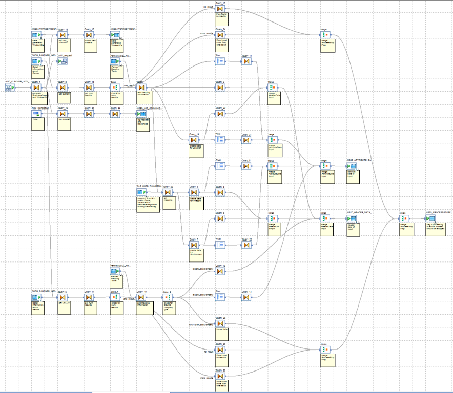

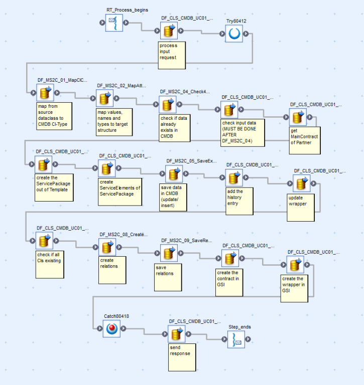

Well, because of the high complex requirements I need a lot of Dataflows (as you can see in attached “JobDesign.png”) for creating some kind of “Framework”.
To provide data from one Dataflow to another, I use database tables (see attached “Merge.png”).
I already tried to decrease number of used tables by merging data before inserting it.
But the benefit was only 80 processes (better than nothing but I hoped for something about 200…).

Processes vs Sessions: If you have parallelism turned on for your tables then a single Dataflow connection (Session) could very well spawn additional processes. Consider turning OFF parallelism to reduce the impact.
Using database tables in your “framework”: I have started using files for intermediate storage instead of database tables. This has improved the execution speed of my jobs (batch, not realtime) through a reduction in network traffic as well as database overhead. Plus, the DBA is quite happy to not have the redo/undo logs getting bloated.
