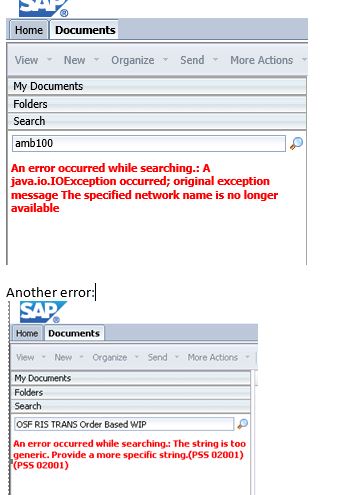

We recently upgraded the content of our 3.1 InfoView to 4.1 Bi Launch Pad. We are now having an issue with the Search option in BI Launch Pad. We intermittently get an error saying “An error occurred while searching: A Java io.IOException occurred” or the error may be “The String is too Generic.” Other times the Search option works as it is supposed to. Is there something we need to do? I added a screenshot of a couple of the errors. Thank you for any help!

we are in BO 4.1 SP4 and still testing is going on. the same problem we are also getting. Try once with searching string inside double quotes (“”
) and also please have a look on below links might be helpful
and also there is KBA inside by SAP. Please go through all these and post updates
