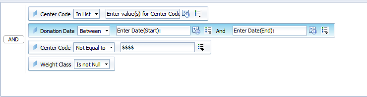

Currently I have a report that runs with entry of Start and End Dates. (prompts)
I would like to have the option to schedule the report and have it delivered via email to the users for current_date-1 for selected centers to automate.
Can this be done within the existing report or do I need to build a new report and how can I do this? Any help would be appreciated! Thanks in advance.

this is how my prompts look right now
