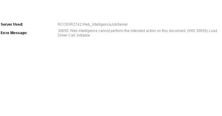

We have 5 monthly scheduled reports that have failed with an error .
I am giving the screen shot for the error.We are using Webi Xir2 version 11.5.10.1263 with oracle as Data base.Can some body please help me get the solution for this issue.

Error #30650 is due to the Web Intelligence server is unable to complete the current task, because of lack of resources or access problems.
It is usually an issue with the security given to your profile. Try to log on as an Administrator and schedule the report.
Also, try to open the report and refresh it from there…

It could be either a corrupt cache or incompatible WEBI report format issue.
See the following 2 SAP notes for further detail:
[list]1314209
1199608
