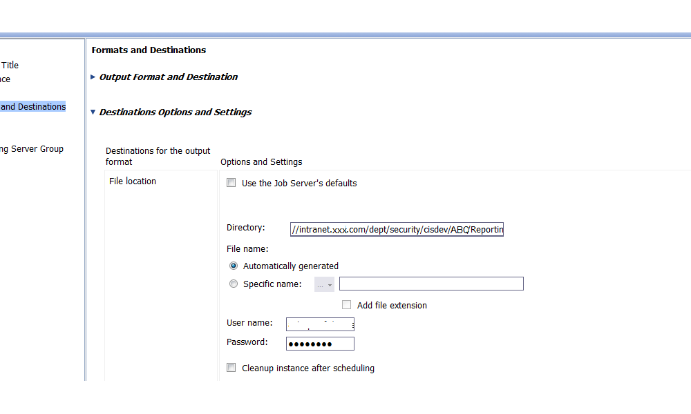

In the schedule setting from the reprot that I want to publish, I am checking at the “File Location” option at the Output Format.
And at the Destination Option & Setting, i am puttring the UNC path in the box (refer attachment). Is this what you mean (sorry if this question sound stupid but I am cracking my head where to edit this setting anymore) :hb:

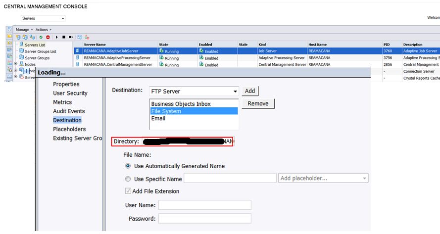

I believe this needs to be set for the actual webi job server(s) which are accessed via the servers section in the Central Management Console.
Right click the server, view the properties and find the destinations dialog. Add your UNC under “File System”.
Edit: Pic added, changed server from DESTINATION to JOB.
