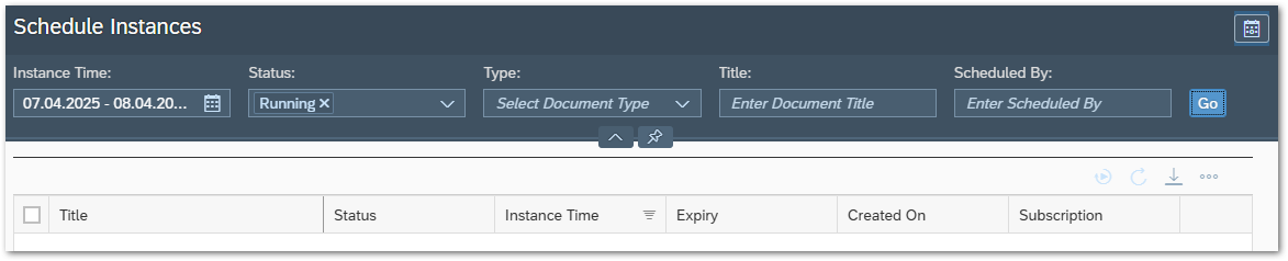

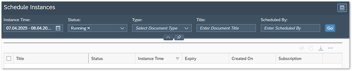

I would foresee a list similar to this from the Instances with a Status of âRunningâ from the BI LaunchpadâŚ
If I make a selection and by the time I schedule the report to wait for is no longer running then I would want the report I am scheduling would run immediately.
