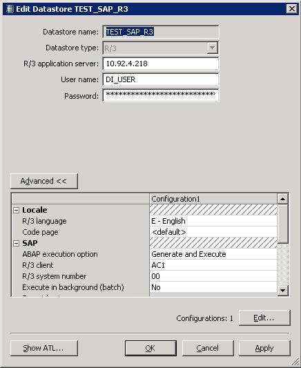

However, we create the R/3 Data Store in DI with the R3 aplication server adress, user, password, R3 client and R3 system number as shown in the SAP GUI connection and we receive the error shown in the attached file:

No problem, here are the screenshots of the SAP GUI Logon and the Data Store definition.
I think we have used the information in the correct order, is it ok?

It is as I said, you mistreated SystemID AC1 as client number. Logon to the SAPGUI, you will find in that logon screen the client to be used.

You are right, we have introduced the wrong value for both the R3 client and the R3 and the system number!!
