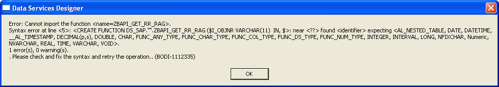

I changed the data element to have a domain of VBELN and then BODI imports the field alright. When I switch the domain back to ZARAG_TXT it fails with the attached error.
