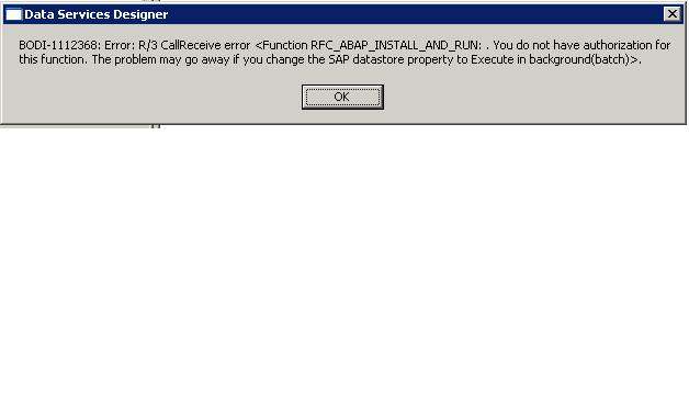

SAP Connection Error
ERROR: R/3 call recieve error. You donot have authorization for this function.
PFA to get the screenshot of error

In the /nse37 transaction, were you able to open the function module? And what happens if you click on single-test and actually execute the function with no parameters? You should get an error saying that you haven’t specified parameters but I bet you get an authorization error instead.
I am able to see the function using Display.
The time when i click or use F8 to execute it.
the error comes “You donot have authorization for this function
Thats why i was asking about the type of authorization required to access the RFC_ABAP_INSTALL_AND_RUN.

Show that to your SAP basis people, they have ways to find out.
Usually S_DEVELOP role is what is missing.
S_DEVELOP and S_ADMI_FCD
S_DEVELOP is already given. but BAsis team is not sure about S_ADMI_FCD role for Testing.

Fully agree with your Basis people, the datastore setting “generate_and_execute” is for development and needs all these permissions. For prod you use “execute_preloaded” which needs none of these permissions but the DataService provided SAP function installed.

Got an error msg 1
BOBI : 1112368 Error R/3 Call Recieve error <Function RFC_ABAP_INSTALL_AND_RUN: You donot have authorization for this function. The problem may go away if you change the SAP datastore property to execute in background(batch)>

With half authorization we tried again …Now got and error
BOBI : 1112368 Error R/3 Call Recieve error <Function RFC_ABAP_INSTALL_AND_RUN: SAP System has status 'not modifiable'.The problem may go away if you change the SAP datastore property to execute in background(batch)>.
Finally, It has conyed from you that we can got Execute_Preload approach which doesnot need any authorization to be given. So concluded because of authorization descripencies, we should go ahead and use Execute_Preload instead of Generate_and_Execute for all three Development, Test, and Production.

Okay. Another option would be to to install the DS provided SAP functions, then the error with the “SAP system cannot be modified” will go away as well.
