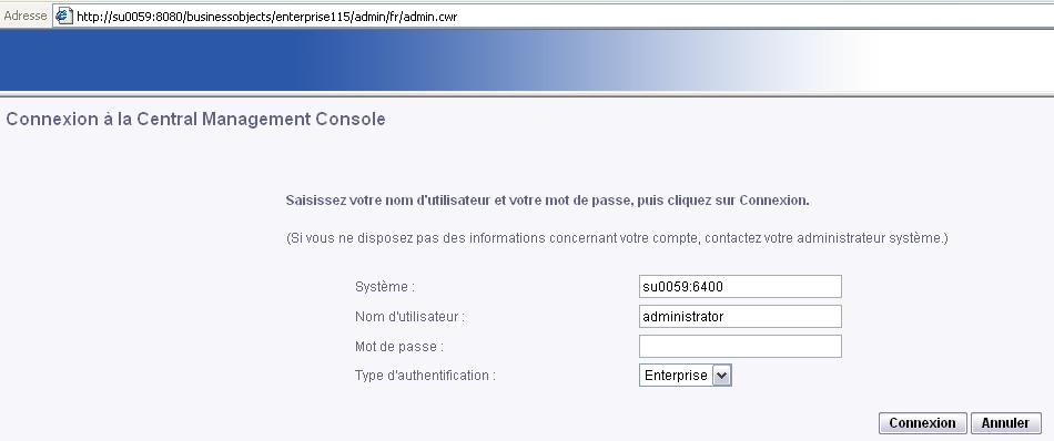

1.jpg : I could log on the system, using the same system name that the name used in the url (i.e. : “su0059”).

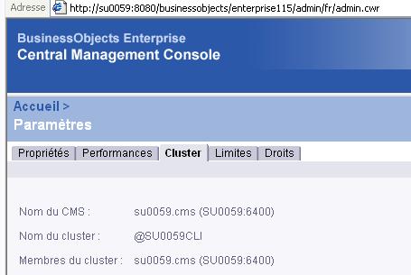

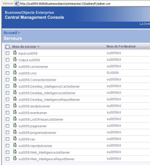

2.jpg : Some servers are named “su0059cli” instead of “su0059”. I don’t know where BO finds this information…
3.jpg : It seems that BO is using a cluster… How can I remove it ???
