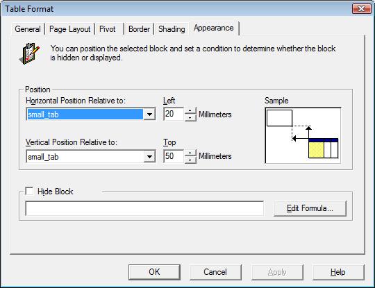

I have two tables in the report.
the records in first table vary when refreshing the data.
sometimes it overlap the second table.
how can I define the relative position of second table depends on the length of first table?
I tried to use the apperance setting. but it is based on the top of first table instead of the end of first table. when the data vary, i either get a big gap between two table or overlapping. :frowning:
please advise.

Give the first table a name. Then go to the appearance tab of the properties of the second tab and position it vertically relative to the first table - there should be the name of the first table in the drop down menu where you select relatively to what to position the second table.

actually I did exactly the same as you suggested, but BO seems behave differently.
after setting the relative position of tab2 against tab1, it was fine with current data.
then i try to refresh, data grows in tab1. Tab2 seems still in the same ‘relative’ position as before refreshing data and casue overlap. :frowning:
could it be a bug in my rather old version 5.1.7 BO running on VISTA?

It could be, it certainly not a supported configuration. What exactly do you see at the moment when you look at the positioning dialogue box?
i believe my setting is correct.
(try to attach the setting for second tab. I called the first tab as small_tab.)

Use only vertical position relative to the first table. Keep the default value (upper section) for the horizontal position.
still no luck. :frowning:
the relative position is not really ‘relative’ after refreshing more data.
I think i have to convince the business to upgrade BO…
runner :uk: (BOB member since 2009-02-24)
The above works for me very well. So it’s perhaps your using BO 5.x on Vista that’s causing the problem.
Yes, BO 5.x has not been a supported version for a long long time. So it’s time to upgrade :wink:
