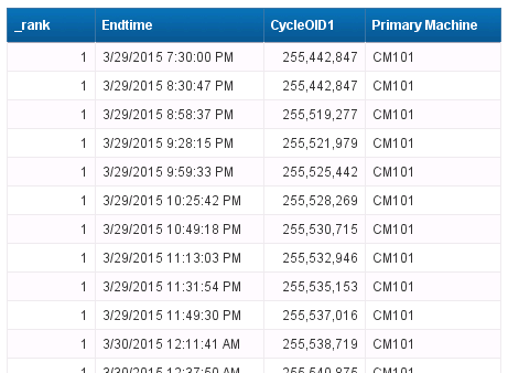

I have a table as per the screenshot
rank, endtime, cycleoid (a measure), primary machine
I wish to have a rank function that will reset on PRIMARY MACHINE. For this, I have created the below variable. However as per the screenshot, the ranking is not behaving correctly, I get a β€˜1’ for every rank entry.
=Rank([CycleOID1];[TruckCycles].[Primary Machine])
Any help would be appreciated.

Primary machine is the same for all those rows?
Hi Mak, no it isnt, it eventually changes (but many rows later)

Are you sure that the calculation context is set right?
It is a Measure variable with datatype numeric. I have also tried recreating it with a dimension object but the same problem occurs.
fghs_1987 :uk: (BOB member since 2008-01-02)
I have resolved it. I don’t know if this is new behaviour with BI 4.1 SP5 but basically you must specify whether you wish for Top or Bottom. The resolved variable is this:
=Rank([Endtime];Top;[TruckCycles].[Primary Machine])
