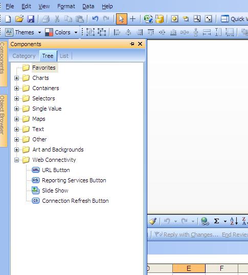

you can find Qaaws , Webservice connections under Data–> Connections(Ctrl+M).
Hope this Helps…

Maybe you can try the “Connection Refresh button” in that same category of components? You can bind your qaaws connections to that object as well.

    All I see in mine is Web Connectivity Components are -
  3. URL Butoon
  4. Refresh button
  5. Reporting services button
  6. Slide show
Am i missing the “Web service connector” component or is there any other way of bringing the data into the canvas
