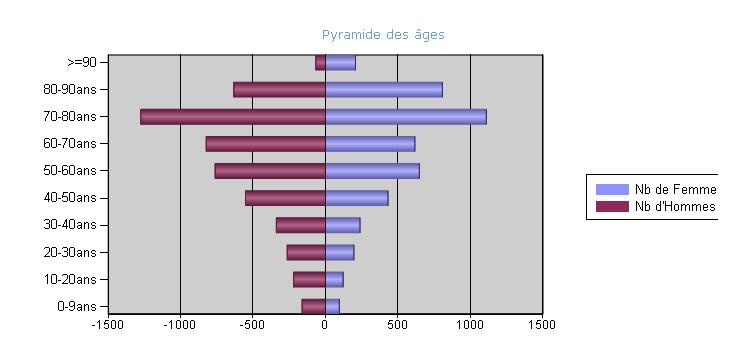

hi all,
i have a table that contain the sex and the age of customers,
i want to have pyramid chart(i dont know how you call it), you could see the chart i want through the attachement ,

A horizontal bar chart? I think that functionality was introduced in 6.5.1…what version are you on?
Nick Daniels (BOB member since 2002-08-15)
thanks
i use bo5 there is no solution
a_shraideh (BOB member since 2006-07-05)

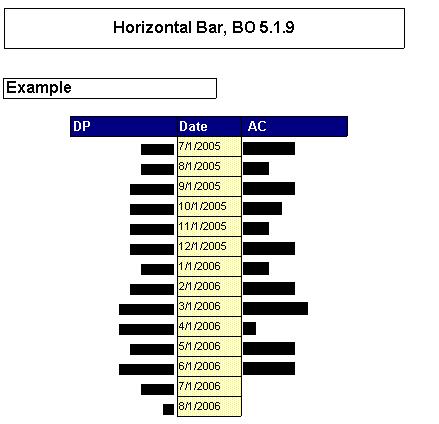

Horizontal Chart in not possilbe in BO 5X but there is a work around. I don’t know if you like it.
now format the number
Go to font → font type (Webdings) → font size (try making less than 10)
kool (BOB member since 2005-04-15)
That is a quality work-around - well done!
Hi! I tried creating this one however, it didnt work?
Can you expound more on the formula?
What does ‘g’ means? Thanks!
bi-bo (BOB member since 2009-12-11)
“g” is simply the character that will then be formatted with the Symbol font later on. It may or may not work depending on the character set in use.
Dave Rathbun (BOB member since 2002-06-06)
oh yeah i got it. thanks so much!
