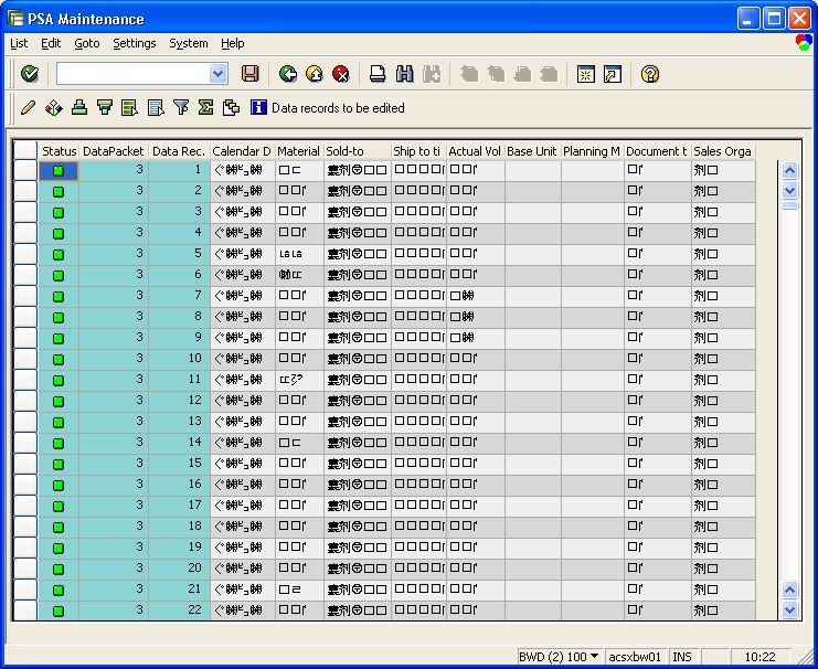

I’m loading data to PSA BW and the same data to a template table on SQL Server. The view data shows a correct information in template table, but PSA shows strange characters. How can I fix it?

What is the data supposed to be - to me it looks like Japanese (Kanji) that was treated as unicode somewhere along the way. I am just guessing, but I saw that same picture a lot when running local Japanese data thru processing that split the bytes and translated each.
Just putting that out, in case it gives you any ideas - good luck!
