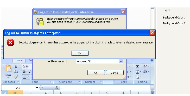

hi thanks for your reply.
im attaching the screen shot of the error.
“Security plugin error:an error occured in the plugin,but the plugin is unable to return a detailed error message.”
thanks
vicky111 (BOB member since 2008-07-08)
Hi vicky
I think this is not an Xcelsius error. Plus, I don’t think it is a BOE error but I see you are using Windows authentication. Couldn’t it be the problem ?
When you connect to InfoView, do you use Windows authentication or Entreprise ? And does it work ? You need to use the same login/password/authentication.
I don’t know the error so maybe it is something else, but have a look at this and let us know what you find out.
Edit : when I export and choose “Windows AD” I have the same error. But I don’t have problem to connect to BOE InfoView. So if you manage to connect to InfoView, then you should use same login/password/authentication.
titlola (BOB member since 2007-01-10)
