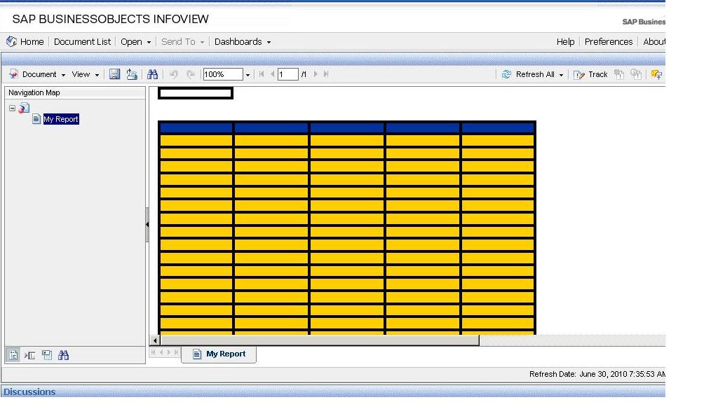

Hi ,
When i try to open a report which was created using JAVA SDK , it is not showing up any value. Instead,some colored cells are getting displayed. But document is getting fetched properly. Values are being retrieved properly.
Please find the attached screenshot .
Please help me
[/img]

Almost looks like the data provider may not be linked correctly.
What happens when you refresh the report?
kmcmanus (BOB member since 2005-09-02)
No. it retrieves data. When i try to go through the recordset and display the result , it works fine. :nonod:
It is fetching data properly but display issue persists.

If you edit the report and view the structure are the objects from the data provider tied to the cells of the block?
I am creating report with JAVA SDK . I am displaying a report with HTMLView. So dont have View structure option with it.
madhu_sushmi (BOB member since 2010-06-21)
But if you edit the report using Webi check to see if the data provider objects been properly tied to the block cells. The results window looks as if it is not the case.
Since I see it is yellow are there also alerts being processed?

Data provider is properly connected. It is showing exact number of rows but it shows only yellow colored cells
